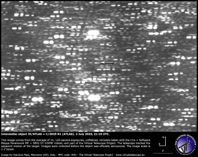

I personally observed 3I/ATLAS on the evening of July 2, before its official announcement. The observation was made using a 360 mm telescope located in Manciano (GR), Italy, under one of the darkest skies of the Italian mainland. The resulting image is attached.
